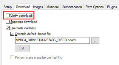

Today I did the following experiment. Using IAR Embedded Workbench, I loaded firmware into the STM32F746 Discovery board.
Then I read the contents of the external flash memory using the SMT32CubeProgrammer and compared the read values with the hex file generated by IAR. These values completely matched. From this I conclude that the verification error is related to a flaw on the IAR side.
So far I have not found a way to fix this error and simply disabled the verification option as shown below.
I really hope that the company ST Microelectronics, in cooperation with IAR, will correct this error soon.
If anyone has encountered a similar problem, please write. I wonder how you solved this problem.
Thanks!
