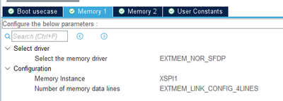

Below I shared the configuration:
XSPI1:
EXTMEM_LOADER:
EXTMEM_MANAGER:

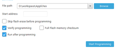

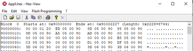

I created an application hex which is located at 0x90000000 and tried to write this file to external memory by using generated loader. Here is the result:
00:51:51 : Opening and parsing file: Appli.hex
00:51:51 : Memory Programming ...
00:51:51 :   File          : Appli.hex
00:51:51 :   Size          : 8.54 KB
00:51:51 :   Address       : 0x90000000
00:51:51 : Erasing memory corresponding to segment 0:
00:51:52 : Erasing external memory sectors [0 2]
00:51:52 : Download in Progress:
00:51:52 : File download complete
00:51:52 : Time elapsed during download operation: 00:00:00.584
00:51:52 : Verifying...
00:51:52 : Read progress:
00:51:53 : Error: Data mismatch found at address  0x90000002 (byte = 0x00 instead of 0x01)
00:51:53 : Time elapsed during verifying operation: 00:00:00.538
00:51:53 : Error: Download verification failed

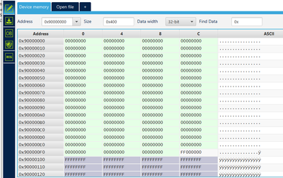

When I read the memory I see this:
How can I fix this problem? Thank you.
