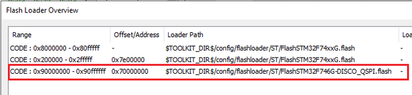

I am using mb1191-F746NGH6-C01, IAR Embedded Workbench for ARM 9.50.1.69506, CubeMX V6.12.1 and
TouchGFX V6.22.0. I generated the project in TouchGFX for IAR. TouchGFX locate the backgrounds and widgets in external flash memory. The Discovery STM32F746 board has MT25QL128ABA1EW9 memory.
In IAR I select "Use Flash Bootloader"
Select STM32F746G-DISCO_QSPI.flash
When I press the button "Download and Debug"
I have the next information in the log:
Wed Oct 16, 2024 21:00:42: Hardware reset with strategy 0 was performed
Wed Oct 16, 2024 21:00:42: Verification error at 0x9000'0000: mem = 0x00, file = 0x0B
Wed Oct 16, 2024 21:00:42: Download completed but verification failed.
Wed Oct 16, 2024 21:00:42: Target reset
Wed Oct 16, 2024 21:00:42: There were 1 error and 1 warning during the initialization of the debugging session.

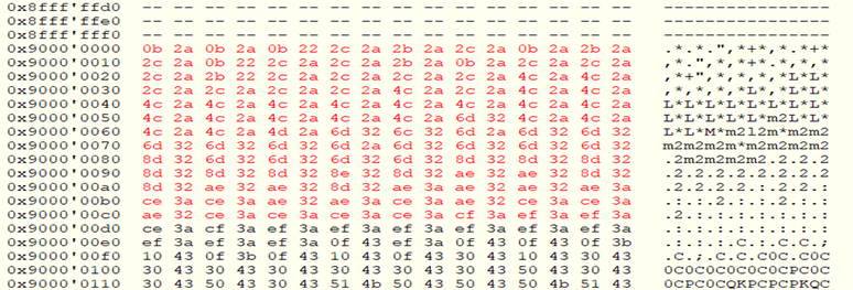

Memory window in the IAR
Part of the array where it is stored backgrounds image

1) I can't understand what the file = 0x0B means in the following error?
2) Where can I find this file?
3) I don't understand why there is a verification error? Where did I make a mistake? Perhaps additional settings need to be made? I would be very grateful for any help and ideas.
The project is attached to this post.
Thanks!

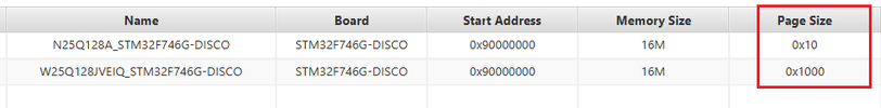

2024-10-17 5:26 AM
The N25Q128 is just a much earlier variant of the Micron part, perhaps with an older die, when ST/Micron were fab partners. I'd imagine the newer parts have shrunk die to increase wafer yield as part of Micron's longevity model, which is form-fit-function not making the same die for decades, allowing them to pivot into new tighter geometries as fab tech advances.
Similarly the page size of both the Micron and Winbond are 256 bytes. The loader does the deblocking internal when given a large buffer. Cube Programmer uses this value as a guide to how to align Write() requests on a address and size basis.
The Winbond and Micron have slightly different architecture, and management of status registers and mode.
Old and new Micron parts are subtly different but shouldn't cause failure. Some issue with IAR's script here
2024-10-17 1:38 AM
File would be the .ELF and the section within the object file describing the 0x90000000 address space.
The memory dump from the debugger, via memory mapping looks ok.
The external loader from IAR seems to be having less success reading the content it just wrote.

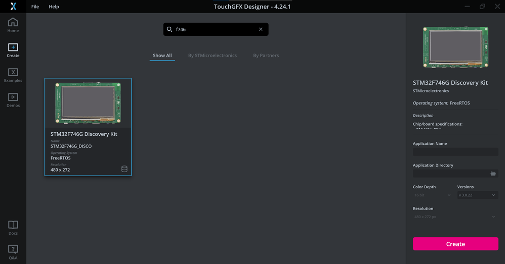

2024-10-17 3:34 AM - edited 2024-10-17 3:35 AM
Hello @Alex_777,
TouchGFX supports IAR Embedded Workbench, and if you use the provided TouchGFX Board Setup (TBS) for the STM32F746G Discovery Kit, then you can open the STM32CubeMX project (.ioc file), and change the Toolchain/IDE from the "Project Manager" tab to EWARM, and press generate code. Then, from your TouchGFX project, you have generate code as well. By navigating to the EWRAM folder in your project's directory, you can access the IAR project. The required settings are already provided; therefore, you don't need to change anything.
TBS for STM32F746G Discovery Kit
EWARM directory
If you still have trouble downloading the program to your board, you can compile the program by IAR, and use the outputted .hex file to download on your board with STM32CubeProgrammer. You can read more about this process here.
I hope this helps you!
2024-10-17 4:30 AM
Hello, Mohammad MORADI ESFAHANIASL
Thanks for reply.
You wrote the next:
I know about it and it was my first actions yesterday. If I do as you write, I get the following error:
Flash download warning: 358130 out of 358130 bytes from data record CODE:[0x9000'0000,0x9005'76f1] will not be flashed.
If I enter the settings that I wrote above, I get an error only with verification.
What could be the problem?
Thanks.
2024-10-17 5:02 AM
As for the program STM32CubeProgrammer, it does not support the memory MT25QL128, you need to create the .stldr file manually.
Memory chips N25Q128A and W25Q128J has the same page size - 256 bytes.
Why do we see different page sizes in STM32CubeProgrammer?

2024-10-17 7:42 AM
Perhaps by reviewing the file in a "File/HexViewer"
So of IAR's implementation is scripts.
Size, make and model can be derived from the JEDEC ID (0x9F) to manage a group of devices.
I think the .MAC relates QSPI peripheral, bank and pins of specific board implementation.
Where as ST's implementation is more rigid, built for board specific hardware situation.
Keil has loaders in \Keil\ARM\Flash, and within the .PACK (.ZIP) files, some of the new STM32 models have loader source within the packs, along with the binary .FLM (.ELF) objects. You need enough RAM allocation for the loader/data being executed on the STM32 side.
