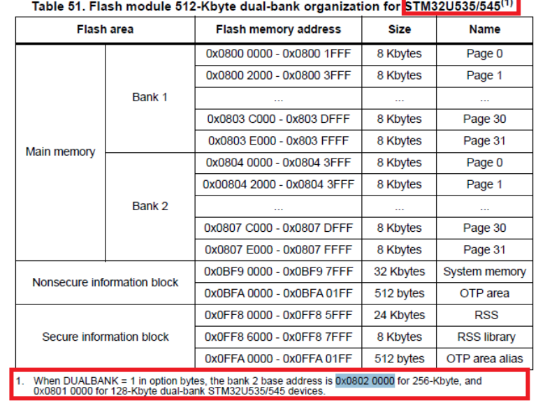

For a 256-Kbyte STM32U535/545 dual-bank device, according to RM0456 Table 51, the flash is organized as:
  • Bank 1: 0x08000000 to 0x0801FFFF
  • Bank 2: 0x08020000 to 0x0803FFFF
Your current config for secure area 1, is setting pretty much the hole flash as secure, that's why you cannot upload the none secure application.
The correct config for secure area 1 and 2 is as follows :
Secure area 1:
SECWM1_PSTRT : 0x0 (0x8000000) SECWM1_PEND : 0x0F (0x801E000)
Secure area 2:
SECWM2_PSTRT : 0x0f (0x803E000) SECWM2_PEND : 0x0 (0x08020000)
