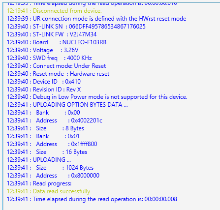

srinathr
Associate II
Capture.PNGit's look like, the power configuration is not low.
and the other problem which I am facing is while I am trying to debug the code I can't.

Hello;
Sorry I didn't understand your reply.
"but when the debugger tries to run"
You have issue with CubeIDE right?
Why are you showing CubeProgrammer screenshot?
When I asked if you are having low power config it was about your application. So if you have for example in your code you put the device in standby mode you will lose the connection. So there is no relation with CubeProgrammer here ..
