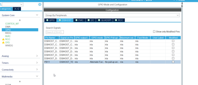

To prevent tearing, you can use the pin called DSIHOST_TE in STM32CubeMX:
This pin is setup when you enable the DSI host in STM32CubeMX. This is the pin you should connect to your screen to prevent tearing.

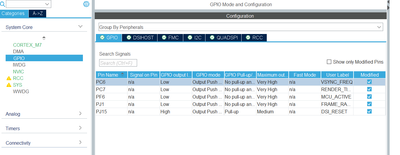

However, if you want to measure performances, you can look at the pin VSYNC-FREQ that you have to manually set :
Regards,
