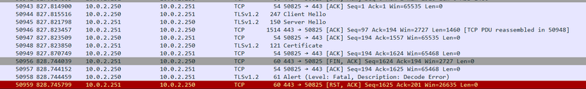

I am currently implementing an HTTPS server using mbedTLS 3.6.5 and LwIP on an STM32H7S7L8 platform running FreeRTOS.
Our mbedTLS configuration are fully functional, as we already have a stable, working TLS implementation on an MQTT client using the same stack.
However, we are encountering an issue during the TLS Handshake phase on the server side after configuring the client sockets to non-blocking mode (O_NONBLOCK). While the listening socket correctly accepts incoming connections, the handshake loop fails.
I have attached the relevant snippet of our server thread implementation, including our I/O callbacks.
Could you please review our non-blocking I/O logic and handshake loop to see if we missed a specific configuration requirement or state handling for mbedTLS 3.x in server mode?

openssl s_client -connect 10.0.2.251:443 -debug -tls1_2
Connecting to 10.0.2.251
CONNECTED(00000190)
write to 000002016EA017D0 [000002016EA19D90] (193 bytes => 193 (0xC1))
0000 - 16 03 01 00 bc 01 00 00-b8 03 03 5a c4 e3 55 0d ...........Z..U.
0010 - 51 ed d7 fd 27 c6 cf d8-cc 97 ef 92 29 a2 eb 96 Q...'.......)...
0020 - 24 3f b2 61 4b 7c 83 01-88 be a0 00 00 36 c0 2c $?.aK|.......6.,
0030 - c0 30 00 9f cc a9 cc a8-cc aa c0 2b c0 2f 00 9e .0.........+./..
0040 - c0 24 c0 28 00 6b c0 23-c0 27 00 67 c0 0a c0 14 .$.(.k.#.'.g....
0050 - 00 39 c0 09 c0 13 00 33-00 9d 00 9c 00 3d 00 3c .9.....3.....=.<
0060 - 00 35 00 2f 01 00 00 59-ff 01 00 01 00 00 0b 00 .5./...Y........
0070 - 02 01 00 00 0a 00 10 00-0e 00 1d 00 17 00 1e 00 ................
0080 - 18 00 19 01 00 01 01 00-23 00 00 00 16 00 00 00 ........#.......
0090 - 17 00 00 00 0d 00 2a 00-28 04 03 05 03 06 03 08 ......*.(.......
00a0 - 07 08 08 08 09 08 0a 08-0b 08 04 08 05 08 06 04 ................
00b0 - 01 05 01 06 01 03 03 03-01 03 02 04 02 05 02 06 ................
00c0 - 02 .
read from 000002016EA017D0 [000002016EA1F203] (5 bytes => 5 (0x5))
0000 - 16 03 03 00 5b ....[
read from 000002016EA017D0 [000002016EA1F208] (91 bytes => 91 (0x5B))
0000 - 02 00 00 57 03 03 70 08-7e 01 3e 4f b5 6f 3e f5 ...W..p.~.>O.o>.
0010 - 8b 84 59 4f 77 ba 03 29-25 c9 a1 62 ab 35 44 4f ..YOw..)%..b.5DO
0020 - 57 4e 47 52 44 01 20 a8-e3 64 58 a5 cd 63 1a 92 WNGRD. ..dX..c..
0030 - c9 35 0c 90 00 c0 ae 9c-7b 3d 04 18 15 5a 1e 69 .5......{=...Z.i
0040 - 45 8b 90 e8 03 fd 82 cc-a8 00 00 0f ff 01 00 01 E...............
0050 - 00 00 17 00 00 00 0b 00-02 01 00 ...........
Can't use SSL_get_servername
0000 - 16 03 03 05 f2 .....
read from 000002016EA017D0 [000002016EA1F208] (1522 bytes => 1455 (0x5AF))

depth=1 CN=MonAppCA
verify error:num=19:self-signed certificate in certificate chain
verify return:1
depth=1 CN=MonAppCA
verify return:1
depth=0 CN=localhost
verify return:1
read from 000002016EA017D0 [000002016EA1F203] (5 bytes => 0)
write to 000002016EA017D0 [000002016EA19D90] (7 bytes => 7 (0x7))
0000 - 15 03 03 00 02 02 32 ......2
B4840000:error:0A000126:SSL routines::unexpected eof while reading:ssl\record\rec_layer_s3.c:708:
Certificate chain
0 s:CN=localhost
i:CN=MonAppCA
a:PKEY: RSA, 2048 (bit); sigalg: sha256WithRSAEncryption
v:NotBefore: May 20 12:55:21 2026 GMT; NotAfter: May 20 12:55:21 2027 GMT
1 s:CN=MonAppCA
i:CN=MonAppCA
v:NotBefore: May 20 12:55:06 2026 GMT; NotAfter: May 20 12:55:06 2027 GMT
Server certificate
-----BEGIN CERTIFICATE-----
MIIC9zCCAd+gAwIBAgIULoYoOOgLyWqEt4HRU04Wvo0GX3AwDQYJKoZIhvcNAQEL
BQAwEzERMA8GA1UEAwwITW9uQXBwQ0EwHhcNMjYwNTIwMTI1NTIxWhcNMjcwNTIw
MTI1NTIxWjAUMRIwEAYDVQQDDAlsb2NhbGhvc3QwggEiMA0GCSqGSIb3DQEBAQUA
A4IBDwAwggEKAoIBAQCl1gV2w9zayeyjj/FU5YjNY/X5Xb1hszqw5Au0ypt9+ccr
S6ieqON1fUYEPUzwaoOsrN2u8KZzb6AGYsLlZ9ApKFgkh+FzuA7M9d7LsLRh76Qv
yERw60m75Ef1qZPI+VPOf78zCoBmuqkedBT6VebZlifEZV61bgqDXPQRdZqK+u3S
jYehKn32W6CCGBF8mTavq3afN/oqZVCa6ilBROamDl0HH/x1eZf36Mc8VSBEf7xF
MEoGwW8H1S9zEYlPcfOBzVLMUC8H+Iy2A0HOAwRVYMlAbhMyfbcdBLnnCH/9YfR/
LGsuigdsJHSPr5FSUanJAg8kMC0rl3KRLolcAFGDAgMBAAGjQjBAMB0GA1UdDgQW
BBTvLh7nqZPYHO/Vr5PCVR1y8Zy0pjAfBgNVHSMEGDAWgBQvGhwCusV1c25Kikxj
D5VVjaQ9VDANBgkqhkiG9w0BAQsFAAOCAQEAUgu94/mdSF8tdOQRSzkSk7UZScdu
M2pQHMqim7cPvsyzHOILISx7+Naxrvjc38+7qUB+98GA1AGwwKnNdM52iI0EI+SJ
LhD69LCb79PKQM1/NronClbId3by02Y34DRpHfelaF8RNYdQNDvQGYww/bqlEnev
5l4Wb5jJK4Pe1GwA241OUWxd/Wtvlezfgv4YoD5b6WzRP7TDjlLiIjr7mUEtuqR7
j2WFu0LQT+48LNVUoirGot/5X1UyTpsC7kbBlkdUw9TbAL4ErpmnyWUDgHzLf6LA
rZhcEgIQoyrZnC2ONl++bH5DIrrV2muEWCecHwG3YSAuRdtGvNRXTi4pjQ==
-----END CERTIFICATE-----
subject=CN=localhost
issuer=CN=MonAppCA
No client certificate CA names sent
SSL handshake has read 1623 bytes and written 200 bytes
Verification error: self-signed certificate in certificate chain
New, (NONE), Cipher is (NONE)
Protocol: TLSv1.2
Server public key is 2048 bit
Secure Renegotiation IS supported
Compression: NONE
Expansion: NONE
No ALPN negotiated
SSL-Session:
Protocol : TLSv1.2
Cipher : 0000
Session-ID: A8E36458A5CD631A92C9350C9000C0AE9C7B3D0418155A1E69458B90E803FD82
Session-ID-ctx:
Master-Key:
PSK identity: None
PSK identity hint: None
SRP username: None
Start Time: 1779290438
Timeout : 7200 (sec)
Verify return code: 19 (self-signed certificate in certificate chain)
Extended master secret: yes
ECH: NOT CONFIGURED: -103
read from 000002016EA017D0 [000002016E98CD10] (16384 bytes => -1)static int mbedtls_lwip_send(void *ctx, const unsigned char *buf, size_t len) {
