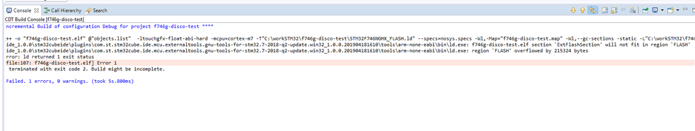

I started from your working project and then added somes images, but then I get this error:
'ExtFlashSection will not fit in region 'FLASH'
I guess it's because the linker needs to be updated to support the QSPI Flash, but could you provide some help about this ?
The article here: https://touchgfx.zendesk.com/hc/en-us/articles/360019884752-Configuring-STM32F746G-DISCO
Only state about the EWARM\stm32f746xx_flash.icf, but the linker file for STM32CubeIDE is totally different, I guess I have to modify STM32F746NGHX_FLASH.ld, but not really sure what to do there.

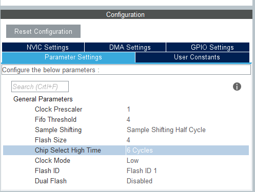

Also, In your video you seems to let the default configuration for the QSPI, but in the article stated above, the configuration seems a bit different:

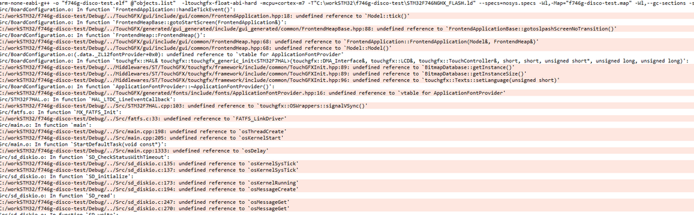

When I configure the QSPI like this and generate again, and after I exlude everything related to the simulator, I get a lot of compilation errors:
any ideas ?

I have some ideas. It's getting late so i'll come up with a reply tomorrow. One hint: When you generate code again, CubeMX will actually delete your OSWrapper_cmsis.cpp source file, causing linker errors. You can reinstate that. Also, yes, i did a quick "initialize peripherals in default mode" and did not do any optimizations as per our written guide just to get a working CubeIDE project. Maybe i should have stated that - Thanks for the tip.

You were right OSWrapper_cmsis.cpp was deleted by CubeMX, i had to copy it from a saved project, and also add some paths to the source paths (Middleware and TouchGFX were missing) and managed to get a compiling project again.
