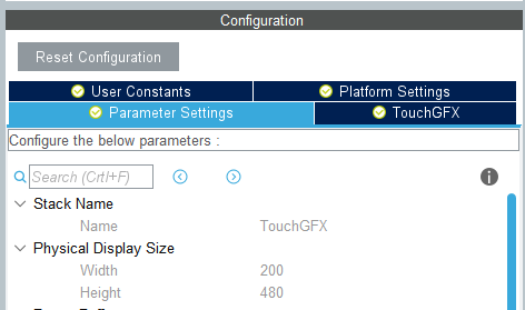

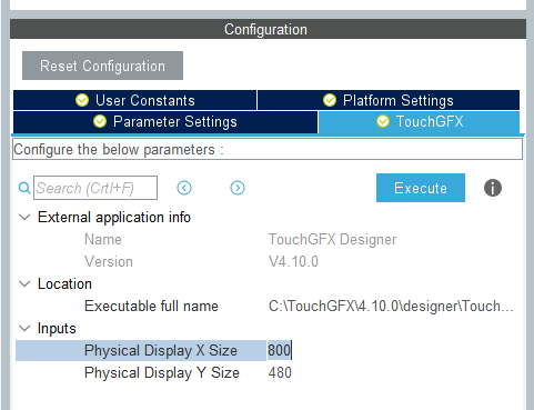

I recently went through the same process for the STM32F769-Discovery kit and had a similar result. No compile errors and when debugging to the kit, the screen was black. I have not been able to get it to work, but I was able to change the size. I could edit the X and Y sizes in CubeMX's Middleware > Graphics > Configuration TouchGFX section. Are you trying to edit the size in the TouchGFX section or the "Parameter Settings" section?
In my case I could edit the sizes in the TouchGFX section but not the "Parameter Settings" section which showed a size of 200x480:
But like I said, I still couldn't get anything on the Discovery kit's screen (it does work if I create a project in TouchGFX and use it's "Run Target" button).

You say it won't let you change the dimensions. Can you show me a screenshot?
Thanks.
/Martin
2019-08-23 5:57 AM
It actually is exactly the same that scottSD posted. I can change it in the TouchGFX section, but not in the Parameter Settings when configuring the graphics. But in the end it doesn't change anything when debugging - the display stays black.
2019-08-23 6:03 AM
The TouchGFX moduie inherits some settings from the LTDC, display size, for instance.
