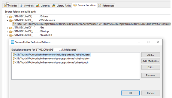

2019-06-05 6:35 AM
Thank you Martin for your 1080p video. I tried to follow it but I have the same problem as last time. When I try to build the project many paths of .hpp files are wrong. The .hpp files exist but the paths are wrong. For example, I get the following error : C:/STM32CubeProject/GenerateurPulse/TouchGFX/gui/include/gui/common/FrontendHeap.hpp:4:10: fatal error: gui_generated/common/FrontendHeapBase.hpp: No such file or directory
So I started add all the paths of the .hpp in "Includes " (Path and symbol window). However it take too much time. Do you think I have a problem with the general properties of CubeIDE ?
Valentin
2019-06-05 9:23 AM
Hi @Valentin Gros ,
I have a problem every time when I generate code in CubeMX, it erases the path configurations and I need to add manually.
Please check your path and symbol window, it needs to be like this (pay attention in excluded paths too):
Regards,
Anderson
