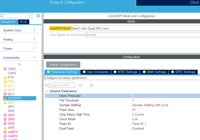

I do some modification and run everything again. It turns out the black screen is due to the Box in black in my splash screen. I changed the color of the Box and the it works. BUT now I think I find the problem and need your help to solve it. The problem is QSPI memory. It seems when TouchGFX wants to load assets from external flash, it faced with hard fault.
In my splash screen there is a LOGO image which it must be faded in after 1-sec. Splash screen loaded and then stuck there. When I delete that LOGO application works fine. That's why I suspect the external flash.
The linker code if as follow

I add some screenshots of my QSPI setting. It maybe worth to note that I enabled QUADSPI global interrupt.

Now it seems debugger do some modifications on external memory. After it finishes the downloading process my application runs very well. :)
The most awkward thing is when I reset the board it does not work again and it stuck at somewhere that screen shows salt-and-pepper noise. :\
