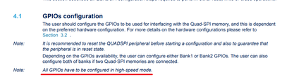

You need also to insure the GPIOs used by the QuadSPI are in high or very high speed mode:
