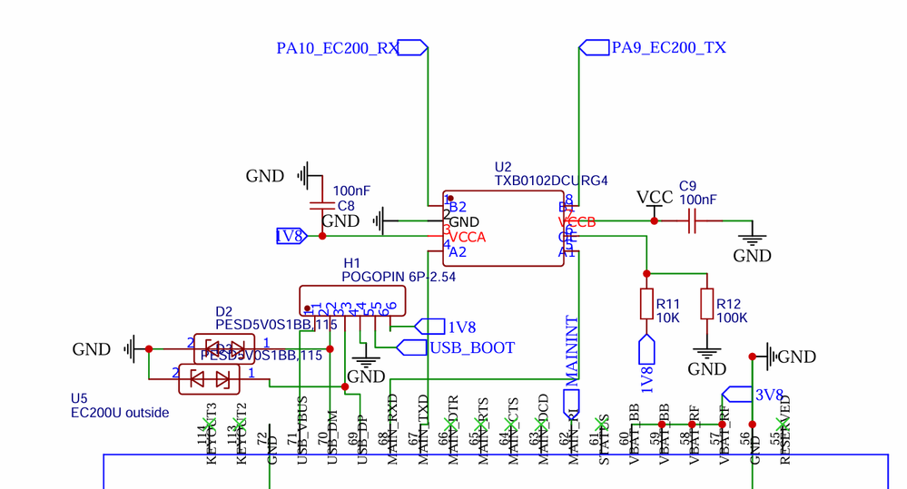

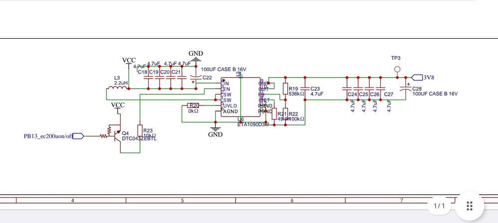

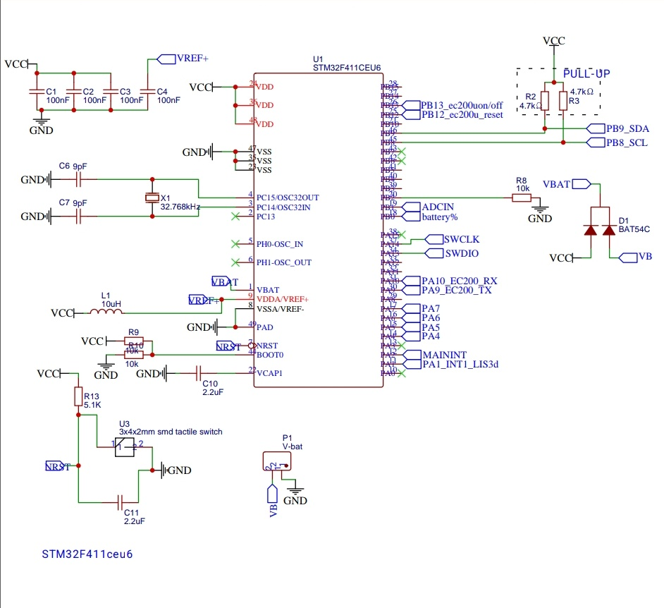

3} i have shared images of schematics . we have connected 2.2uF capacitor to NRST pin.

OK, this looks good to me, my only remarks are:
- The current limit of the Boost converter is set to 3.6A,  but according to the datsheet the effective current limit can be between 2.6 and 4.6A. Assuming that VCC is 3.3V this means the max. output current can be somewere between 2.2A and 4A
- The DTC043ZEBTL is an NPN Transister, but the schematic calls for an PNP (probably working because you are using the B-C Junction as diode).
To investigate the problem You can try to read the RCC_CSR register after the reset.

So it is a power supply issue - your supply is dropping under the load of the TX.
So You have to check Your powersupply, and the relative connections / cables, evidently your supply (with the Boost converter) can not deliver the current needed by the LTE1 module.
