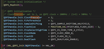

On my STM32H750-dk project, in STM32CubeMX, the sys clock is set to 480 MHz and the clock used for QSPI is set to 240 MHz.
If the extMem_boot sets the sys clock to 400 MHz, the clock for QSPI is set to 200 MHz.
Then you can modify that value with the prescaler.
In your case, it seems to be set to 3 because 200/(3+1) = 50.
But if you set the prescaler to 2, you get 200/(2+1) = 67 MHz, close enough if the max frequency is 90 MHz.
In my TBS, it is set to 2 (so 67 MHz clock, the comment is wrong):

I integrated the QSPI.c file contained in ExtMem_Boot into my code and it works well, but up to 60Mhz at most, so we are far from the data declared in the MT25QL512ABB8ESF-0SIT datasheet that talks about 90Mhz.
Above 60Mhz the touchGfx code crashes.
