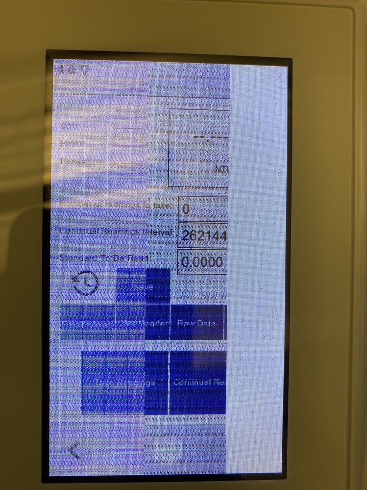

2020-11-12 7:52 AM
@Martin KJELDSEN
Here is what my dynamic bitmap currently looks like when added on top of the active screen. This is of course after updating the cache on the cacheable container, setting the bitmap of a touchgfx::Image, and invalidating said touchgfx::Image.
2020-11-19 4:46 AM
I forgot about sending you the patch, but i'll get it out to you tomorrow, if that's okay.
