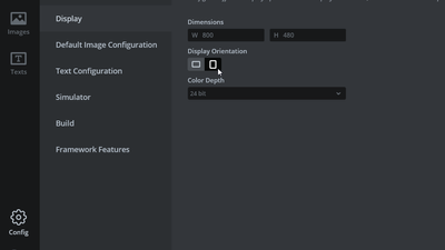

When I change my display orientation in Config => Display like so :

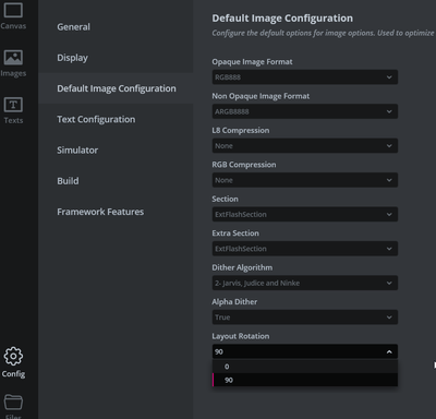

it also changes the default image layout rotation to 90 automatically under Config => Default image configuration.
Perhaps it did not do that for you since you seem to have to set the rotation to all the images manually.
You could manually change the default image configuration so that you only have to do it once instead of doing it for every images :

Hello @jchernus-fikst ,
Yes, this is expected behavior.

2025-02-27 7:23 AM
Hi Gaetan,
Thanks so much for your reply - I'm new to TouchGFX and hadn't yet found the "default image rotation" - that makes so much sense. I will do that instead of rotating each one manually!
