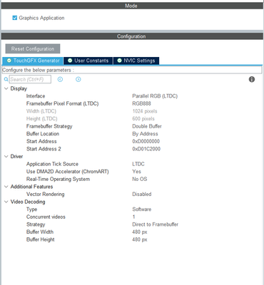

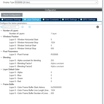

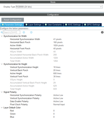

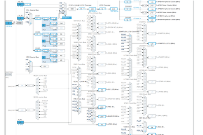

MM..1 thanks for answer,
Pixel clock 48MHz, let me explain better, I don't make the switch from landscape to portrait, the project is directly in portrait.
In the previous videos I show that if I invert "only on touchgfx gui" the orientation from portrait (my project default) to landscape (without changing anything), the pixeling effect does not occur.
I use a double buffer, but even changing to single I get the same effects, even changing the pixel clock I get no results, still the same effect.
SDRAM used 256Mb, font, picture and text on qspi.
Below are some photos of the setup on cubemx.
Really thanks for the reply.
