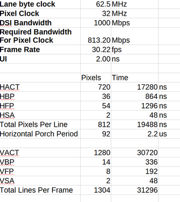

LTDC dot clock used MHz is more info as aiming 30Hz
2025-01-28 8:19 AM - edited 2025-01-28 11:10 AM

I don't think you have an issue with your framebuffer. But to make sure, you could try to check if your data RAM is correct or not. Also, I would try to keep it simple and use portrait mode at first, and switch to landscape afterwards.
DSI screens have the disadvantages of complex protocols and drivers often. I would recommend to double check your implementation for enabling your screen, including checking that you're using the correct values mentioned in your previous message.
