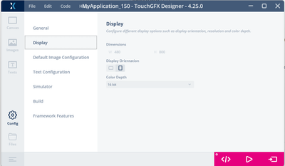

First, you should make sure that your LTDC parameters (clock, porches and so on) match the specifications for your new display in CubeMX.
Regarding the change in oritentation, you should be able to handle this by setting the correct screen orientation in Designer, as shown in the screenshot.
