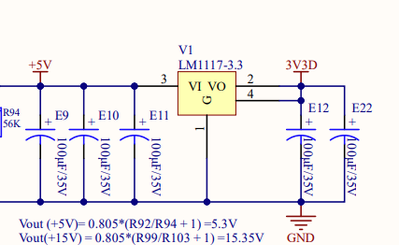

During the power-on and power-off processes of the STM32F407 chip, the GPIO used as the DAC output will be pulled high for 8ms. The goal is that the GPIO should remain low when there is no DAC output. Adding an external pull-down resistor has an effect but cannot completely eliminate it. It was not present during online debugging, only occurring when there was a power surge. After erasing the program, it still existed. Preliminary judgment is that it is a hardware issue. Is there any way to solve this problem?

Yes, it seems that VREF will exceed VDD. Because VREF is derived from 5V, and VDD is derived from 3V3. And 3V3 is obtained by reducing 5V.

Perhaps it is because of the two 100μ capacitors in 3V3D that it fails to synchronize with the VREF voltage obtained from 5V during the power-up/down process. When powered on, the rise of VDD is slower than that of VREF, and when powered off, the drop of VDD is also slower than that of VREF.

I used a Nucleo board which has VDDA/VREF+/VDD all tied, so not quite the same circuit. I thought the behavior was the same but it was not.
Yes, in your circuit it's almost certainly due to VREF+ and VDDA not tracking each other.

If it is in the 5V -> VREF circuit, then its threshold should not affect the result, right? Because its threshold value has little relation to the power-up and power-down speeds of VREF and VDD(The conduction time of the transistor? It should be done soon.). I think the main reason that causes these differences is the two 100μf capacitors connected by the VDD(Charging and discharging time).
