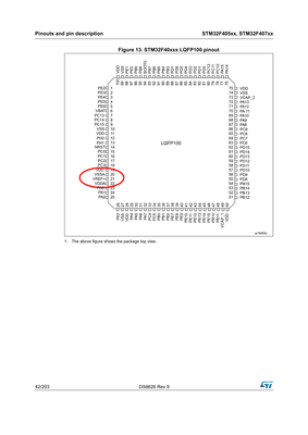

> It seems that the VDDA and VSSA chips are not available.
I don't understand what do you mean by that.
How are these pins connected?
2025-06-06 12:46 AM
VDDA is connected to VDD, and VSSA is connected to GND.

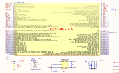

2025-06-06 1:03 AM

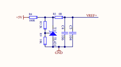

2025-06-06 1:12 AM - edited 2025-06-06 1:15 AM
1. Does the problem happen when you use the reset pushbutton?
2. As an experiment, try disconnecting TL431 from VREF+ and connecting VREF+ temporarily to VDD
3. What if the root of problem is some sort of current injection through the opamp connected to the DAC output, during the opamp's powerup? Try disconnecting the DAC output from the opamp (or removing the opamp itself, whichever is easier) and observe the DAC output alone. Or, alternatively, try to keep the opamp powered up, while powering down and then back up the mcu alone (having some means to disconnect the +5V rail, perhaps).
2025-06-06 1:17 AM - edited 2025-06-06 1:19 AM
1.This phenomenon occurs when the power is turned on and off. The reset button was not pressed.
2.I will attempt to observe the effect of connecting VREF to VDD.
3.Even without the operational amplifier chip, the same problem persists. We have already tried that.
2025-06-08 5:58 PM
Hello. Thank you for your help.After connecting VREF to VDD, everything worked fine. But I still don't understand why there was a problem here. Could you explain the reason?

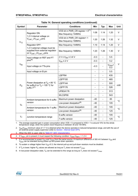

2025-06-09 2:28 AM - edited 2025-06-09 2:36 AM
Well, my guess is, that during the power-up, the following requirement is violated for a short period, due to the VREF+ rising slower than VDDA:
Or, it may be a similar problem, if VREF+ > VDDA briefly during powerup/powerdown.
