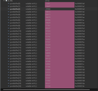

I would like to use the board's built-in microphone to display audio data visualization on an LCD screen. I want to add more display modes later, but at the moment I only have basic waveform time domain display.
I use the built-in microphone to record audio, which I then convert to PCM using PDM2PCM middleware. However, there seem to be no correlation between the sound and the pcm values. Whether I speak, turn the music on, or do nothing at all - pcm values are about the same.

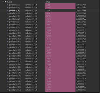

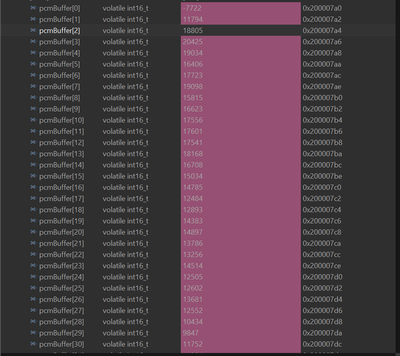

Moreover, every position in the PCM buffer hovers around the same value. For example, some positions are about ~-11000 no matter what, and the other are about ~20k no matter what. So, the audio visualization is almost flat with some random noise.
I assume that there is something wrong with how I use the mic or pdm2pcm.
The I2S and middleware settings
Example PCM values
The code

1 ACCEPTED SOLUTION
Accepted Solutions
Use the board's BSP driver or use it as reference:
https://github.com/STMicroelectronics/stm32f4discovery-bsp/blob/49fcaf442e7d9b5970567eb0c833d66d1333e726/stm32f4_discovery_audio.c
5 REPLIES 5
Ozone
Principal III
I'm pretty sure the "legacy" SPL-based F407 discovery firmware contains an example project for the microphone, if I remember correctly the demo application it came with.
And the SPL firmware contained decent drivers for the STM32F4DIS-LCD module, which I used in quite a few projects.
The F407 discovery was released quite a while before Cube/HAL, so the demo and driver support might be lacking. To be honest, all my F407 discovery projects are based upon SPL code.
Where can I have a look at the SPL example project for the microphone?
