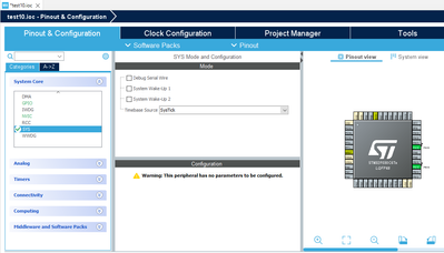

I am reading what you say by translating. I do not understand some of the statements. Is TimeBase Source: SysTick selected?
2024-11-18 10:32 PM
2024-11-18 11:30 PM
TIM16 and debug serial wire .
