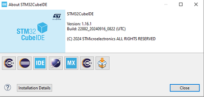

@XooM wrote:I think the problem is that the Hal_delay function is not working. But I still haven't found the solution.
If you tell me your board, MCU and STM32CubeMX version I can check. Hal_delay works perfectly fine in my projects. I cannot replicate your situation if I don't know the details.

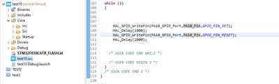

2024-11-19 3:10 AM
Does your board contain an LED?
Have you tried to make a blinky?
Can you send your ioc file?
2024-11-19 3:13 AM
2024-11-19 3:28 AM - edited 2024-11-19 3:28 AM
PA10 is SET but not RESET. It remains stuck in the SET position.

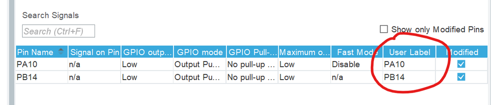

2024-11-19 3:39 AM
Please give pins functional names. It makes it easier to use it in code using the generated defines in main.h:
#define YOURPINNAME_Pin GPIO_PIN_14
#define YOURPINNAME_GPIO_Port GPIOBI noticed pin PINB12 and PINC13 referenced in your start post are missing in the configuration. Please configure all iopins
2024-11-19 3:41 AM - edited 2024-11-19 3:41 AM
I'll take care of them, so why isn't Hal_delay working?
My problem is exactly that the hal_delay function isn't working.
I didn't care about the names because I was writing a test program.
