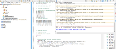

Seems you project isnt configured... HAL_IncTick is in Systick IT handler , but systick isnt configured...
How you manage project ? CubeMX ?
Or timers is misconfigured and ISR took long, then main code never run. Know you how debug code?
Try comment all timers out.
