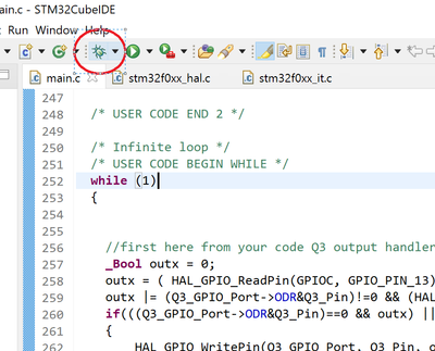

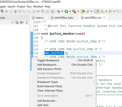

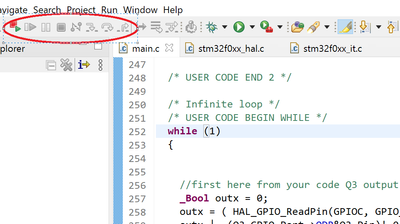

then switch to it.c and click on line set break point , on left click play button learn use debuger ...

Make sure that SysTick is causing HAL_GetTick() to advance.
If it is not, then HAL_Delay() will not work.

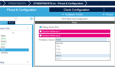

Seems you choice ST versions with some bugy frameworks. I understand your frustration , but try remove systick and use other timebase. Start with open ioc and free TIM16 disable it.
Then choice here
and test your HAL_Delay 500 toggle or my code.
