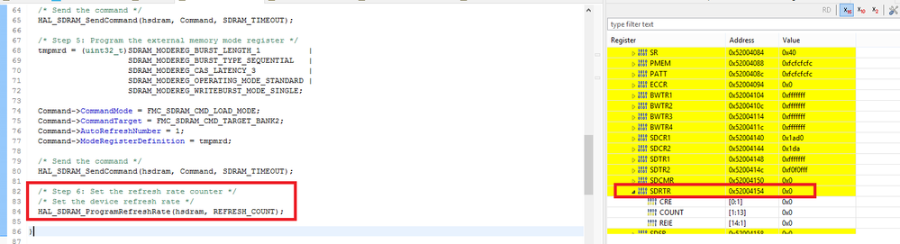

Here some update for the topic.
I was trying to change the refresh rate according to the proposal to 400:
#define REFRESH_COUNT ((uint32_t)0x0190) /* SDRAM refresh counter (100Mhz SD clock) */which is set by the last step in the initialization function:
/* Step 6: Set the refresh rate counter */
/* Set the device refresh rate */
HAL_SDRAM_ProgramRefreshRate(hsdram, REFRESH_COUNT);that runs this one:
HAL_StatusTypeDef FMC_SDRAM_ProgramRefreshRate(FMC_SDRAM_TypeDef *Device, uint32_t RefreshRate)
/* Check the parameters */
assert_param(IS_FMC_SDRAM_DEVICE(Device));
assert_param(IS_FMC_REFRESH_RATE(RefreshRate));
/* Set the refresh rate in command register */
MODIFY_REG(Device->SDRTR, FMC_SDRTR_COUNT, (RefreshRate << FMC_SDRTR_COUNT_Pos));
return HAL_OK;
}So it should set the SDRTR register to the value 0x0190.
After setting a breakpoint just after this function, the register has a value of 0x0:
Now I' checking why this is so, but this dosen't supose to look like this...

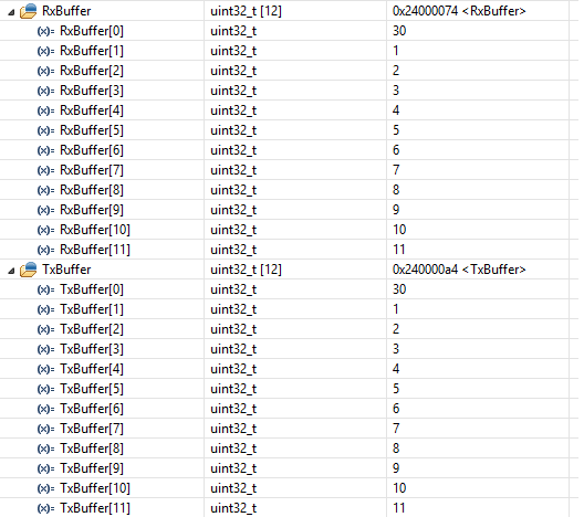

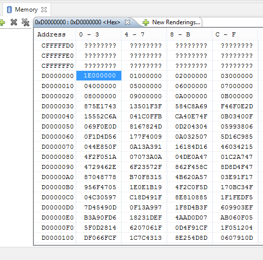

HAL_SDRAM_SendCommand(hsdram, Command, SDRAM_TIMEOUT);I have checked the registers and they are set now correctly.
I also wrote a simple code to do a first test:
The result is fine in memory view and variable check:
Thank you all for all the help!
Now I can continue to write my test code.
