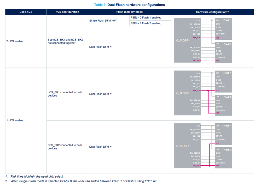

Hello @jyothzz and welcome to the ST community,
I think the answer to you question has been answered in the AN4760 "Introduction to Quad-SPI interface for STM32 MCUs and MPUs" / Table 9. Dual-Flash hardware configurations:
1 REPLY 1
