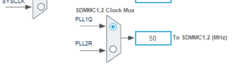

2026-03-14 12:56 AM - edited 2026-03-14 2:09 AM
Set the clock for SD-card to 50MHz .
As this is max frequency for SD-card.
And set 1bit mode at first, as 4bit mode more difficult.
