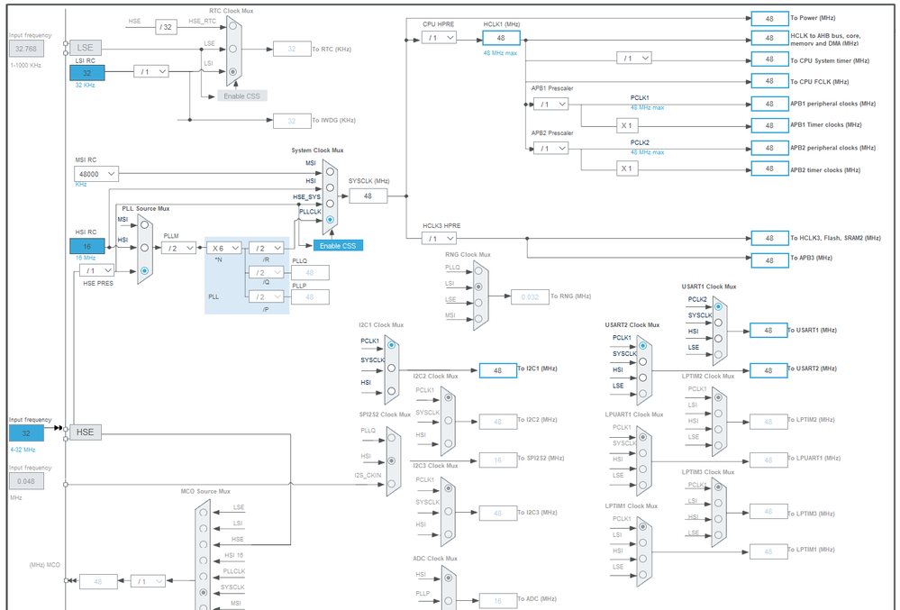

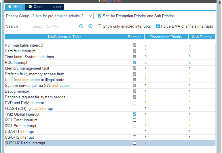

}The LED turns on and the Code gets stuck in the Delay. I do think the interrupts are set right. An this is my Clock Configuration:
I'm thankful for any kind of help.

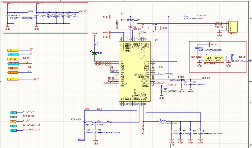

@Javier Muñoz I'm using an ASVTX-13-D-32.000MHz-I05-T for the clock with VDD coming from pin 30 from the uC and pin 26 as RCC_OSC_IN from the clock, but as i said it's also not working with the HSI.
@DavidAlfa HAL_IncTick() was present, I'm using Version 1.6.1 IDE & 6.1.2 CubeMX. I also created a new project with just the GPIO & the clock, but that didn't work either.

Check reset pin, Boot pins, Vcap value.
Post the stm32 schematic or something that could give some hints.

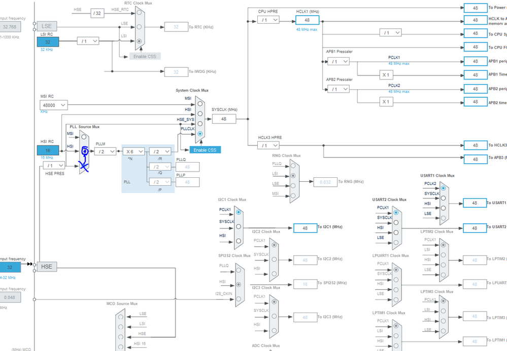

Also with the 16Mhz HSI/MSI 32Mhz no improvement. While stuck in the Delay i did a reverse step, and i think its stuck in:
while ((HAL_GetTick() - tickstart) < wait) { } and then the HAL_GetTick(void) function >
return uwTick;
BOOT0 pin was unfortunately left floating.
i read somethin about the Low Power modes and that the HSI is turned off in certain sleep modes. But i don't think i chose/activated one of those.
Thats the main shematic. Pin 30 is +3V3 for the clock, pin 26 the input.

Set a breakpoint in SysTick_Handler, check if at least it's getting there.
Otherwise, the systick timer is not working.
