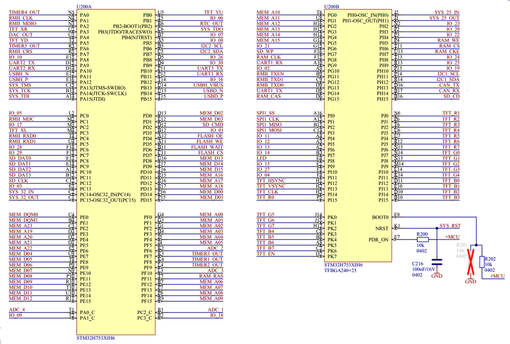

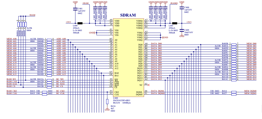

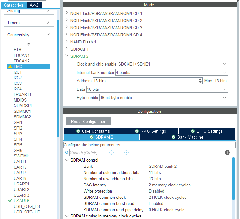

I'm trying to use an external SDRAM (IS42S16320F) with an STM32H753 but no luck till now.
Could please anyone check if my settings are correct because I don't know if I made a bug here.
For that I have attached the FMC configuration and the schematic parts with the SDRAM and uC.
I would be very greatefull for that.

2021-04-07 9:24 AM
Based on very quick scan - column address bits should be 10 not 11 for IS42S16320F and start by running CAS 3 and slow timings until working

Thank you for the quick reply!
I have changed the number of column bits to 10 and the CAS 3 to make sure.

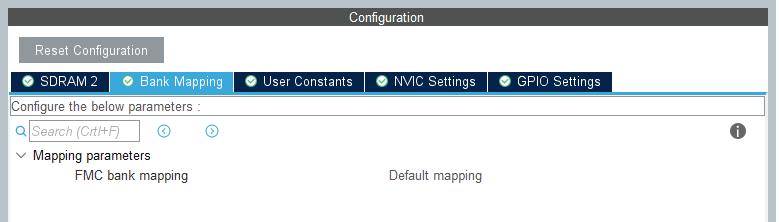

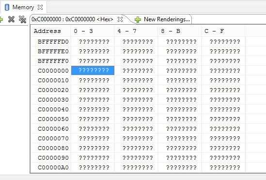

After check with the memory viewer I still can't see any valid address for the standard range 0xC000000:
Also if I check the alternative address mode for 0xD000 0000 I also don't get any valid address:

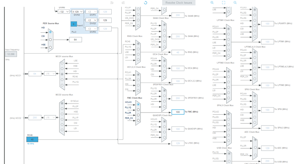

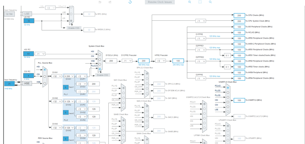

Here are my clock settings (in case I have also made anything wrong also here):

Wouldn't SDRAM2 be at 0xD0000000 ?
2021-04-07 11:11 AM
@Community member : yes, that is why I have checked both addresses, the 0xC000 0000 (default for SDRAM1) and the 0xD000 0000 jsut to make sure. But as you can see from the pictures none of them are available.

2021-04-07 11:45 AM
Ok, so ?? ?? indicates the peripheral isn't even clocking.
You're going to want to double check where exactly you're break-pointing this, and then unpack the RCC clocks and FMC peripheral settings, and confirm they make sense.
Ideally, just do some printf/dumping after you've initialized the memory interface.
Have the Hard Fault Handler output some actionable data, and if it still faults when touching SDRAM2 (0xD0000000), then again suggests the peripheral's not setup/clocked. Getting the odd parameter wrong will yield random data, not ?? ??

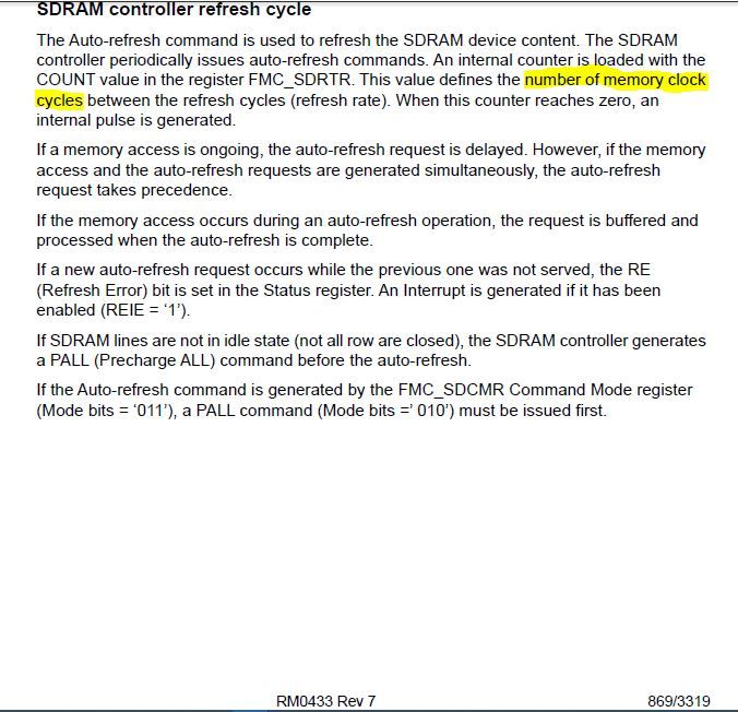

Hello
You didn't published the timings
Check if REFRESH_COUNT is calculated properly for this memory. This sdram chip refreshes every about 8μsec (8K/64msec) for comercial temp range.
Recalculate the counts by multiply 8.192μs *100MHz/2 =820/2 , remove some counts for safety , eg, 15 => 400.
2021-04-07 6:14 PM
