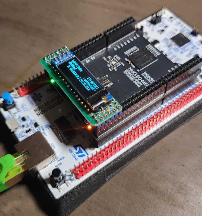

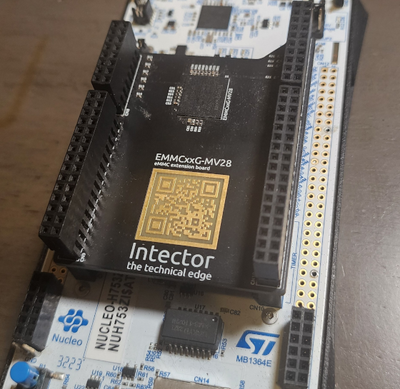

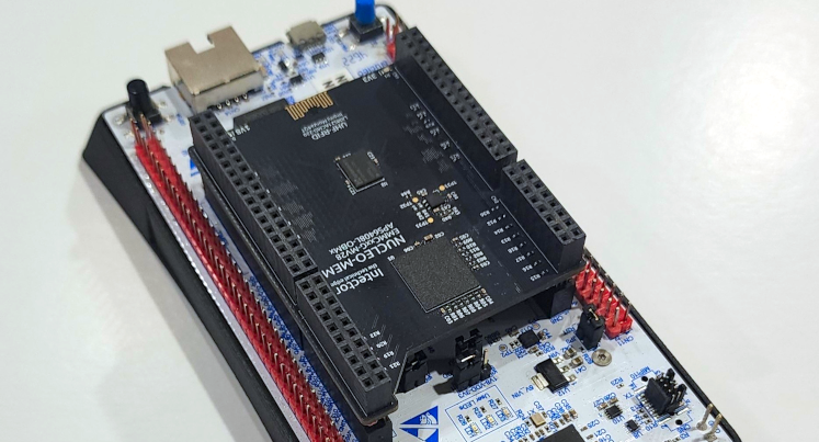

The Hardware: NUCLEO-MEM
Rather than keep working around the NUCLEO-144 limitations, I designed a purpose-built memory expansion shield that plugs directly into the Morpho headers.

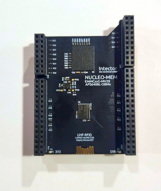

[INSERT IMAGE: pic_01.png — PCB front and back]
The NUCLEO-MEM carries:
  • 8 GB eMMC (Kingston EMMCxxG-MV28) — connected via SDMMC1 (8-bit). Stores the web interface files (HTML, CSS, JavaScript) and provides gigabytes of datalogging capacity.
  • 8 MB Octal SPI PSRAM (AP Memory APS6408L-OBM) — connected via OCTOSPI1. This is the memory that Azure RTOS actually needs to breathe.
  • UHF RFID (Impinj Monza4QT) — unique device identification at up to 10 meters.
In the photos you'll also see an SSD1306 OLED display (128×32, I2C) — that's a separate module plugged into the NUCLEO-MEM headers, not part of the shield itself. It shows network status, IP address, and runtime information.
The NUCLEO-MEM requires an MCU with an OCTOSPI peripheral for the PSRAM interface. It has been validated on the NUCLEO-H723ZG (STM32H723, Cortex-M7, 550 MHz). MCUs without OCTOSPI — like the STM32H753 with its single QUADSPI limited to flash memory — can't use the PSRAM portion. For those boards, I have an earlier EMMCxxG-MV28 shield that carries only the eMMC storage — no PSRAM, but it gives any MCU with an SDMMC peripheral access to 8 GB of FAT-based file storage for datalogging, web hosting, or automated data offload via FTP.
 Designed in Altium Designer, four-layer PCB, all 0402 passives, impedance-controlled memory traces.

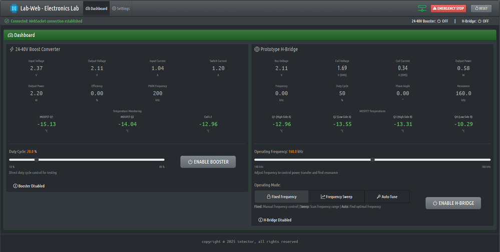

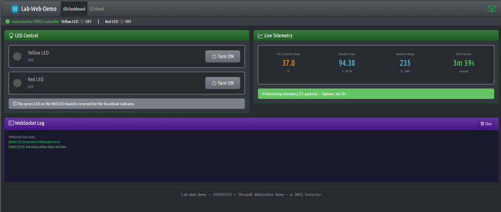

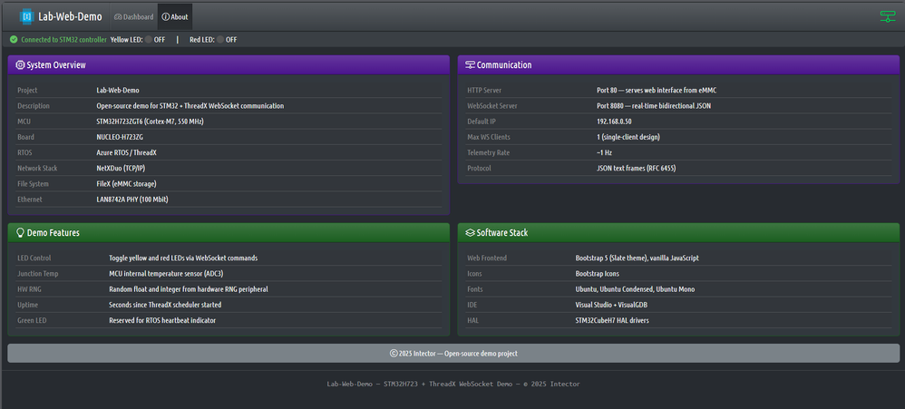

When a user opens the dashboard in a browser, the HTTP server delivers the HTML, CSS, and JavaScript from eMMC. The JavaScript immediately opens a WebSocket connection back to the board on port 8080. From that point on, the browser and the MCU are talking directly — telemetry flows from the board to the browser (configurable rate, ~1 Hz in the demo), and commands flow from the browser to the board instantly. No polling, no page refreshes.
This same WebSocket architecture scales from simple demos to real hardware testing. The screenshots above show the demo project (LED control + telemetry). The screenshot below shows the same platform driving a wireless power transfer test bench — a 24-40V boost converter with a full H-bridge generating 900VAC at 160kHz for magnetic field power transfer.
The demo project in the GitHub repo is intentionally simple, so the WebSocket implementation is easy to follow. Your application replaces the LED commands and telemetry values with whatever your hardware actually does.

The browser receives:
{"type": "telemetry", "data": {"junctionTemp": 42.0, "randomFloat": 73.21, "randomInt": 456, "uptime": 12345}}
This is where the WebSocket advantage becomes obvious. With HTTP polling, you'd be hammering the server with GET requests at whatever rate you need updates. With WebSocket, the server pushes data when it's ready — no request overhead, no wasted bandwidth, sub-millisecond latency.
The Result
The demo project gives you a self-contained reference implementation:
  • A browser-based dashboard served from eMMC over HTTP
  • Real-time LED control over WebSocket — toggle LEDs from the browser, see state confirmed instantly
  • Live telemetry streaming — MCU junction temperature, hardware RNG values, RTOS uptime, all updating in real time at a configurable rate
  • FTP access to the eMMC filesystem for updating web files remotely
  • Full RFC 6455 WebSocket implementation with handshake, frame encoding/decoding, and connection management
The web interface uses Bootstrap 5 with a dark theme, vanilla JavaScript, and connects to the WebSocket server automatically on page load. The WebSocket log panel shows every message in real time for debugging.
Replace the LED commands with your motor controller, sensor array, or power converter, and replace the telemetry values with your actual measurements. The WebSocket plumbing stays the same.
