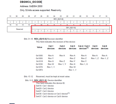

According to the reference manual, the start address depends on the Cat number:
For that you need to read DEV_ID field in DBGMCU_IDCODE register:

> apply +14U
Not 14U, but 0x14.
