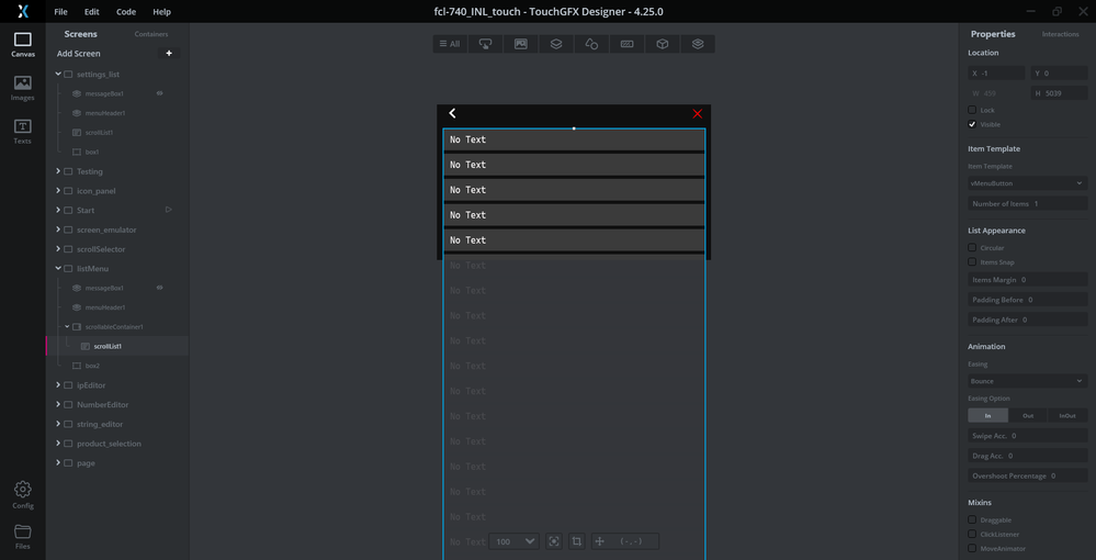

We have an issue with a scroll list widget, on the hardware when you touch and scroll to a point, stop then lift your finger of the display the list accelerates in the direction it was dragged in initially. This behaviour is not seen the simulator.
In the designer, we have scrollable container with a scroll list inside it. Setting animation has no effect, easing option = In, Swipe Acc = 0, Drag Acc = 0, Overshoot % = 0. we have tried adjusting the both Acc without any effect.
The list has up to 50 entries.scroll list
