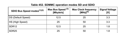

SDcard can have max. 50 MHz clock. See SD specification, at 3v3.
from H743 rm:
