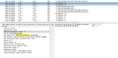

In wireshark it shows as USBD_STATUS_CANCELLED.
