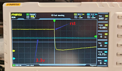

Current debugging progress: When the device restarts, the nRST pin has a low-level time of less than 1ms. The 3.3V power supply pin of the MCU is stable as observed by the oscilloscope. The TP5010_DONE_Pin has a 40ms high-level time during each ten-minute wake-up period (HAL_Delay(1) --> SystemCoreClock configured at 80M, after low-power wake-up, it switches to the default 4M of MSI, reducing by 20 times, plus the HAL_GPIO_WritePin time, which is exactly 40ms), but during the first low-power entry, it has a high-level time of over 20ms (caused by unstable PLL switching to MSI?).

Guys, if the battery was failing or running out, the 3V3 line would be dropping, no? And it wouldn't be recovering after a reset.
2026-01-29 10:45 AM
@TDK wrote:Guys, if the battery was failing or running out, the 3V3 line would be dropping, no?
I get the impression the 3V3 line has only been verified in the lab ?
But the devices are failing in the field - where the state of the battery (and, thus, 3V3) are unknown ?
2026-01-29 12:07 PM
This cleared it up for me. But I could be missing something.
> The oscilloscope captured 3.3V on one channel and nRST on the other, with the nRST channel set to trigger mode. It was found that when the nRST signal had a falling edge, there was no fluctuation on the 3.3V line.
It would always be good to see actual scope plots with this information rather than just text. Sometimes things are left out or misinterpreted.

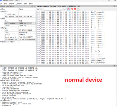

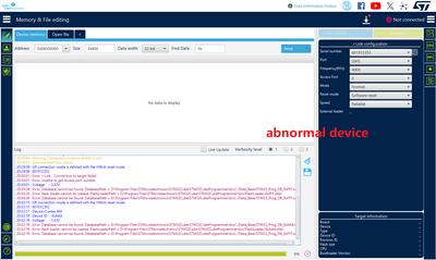

2026-01-30 4:41 AM - edited 2026-01-30 4:47 AM

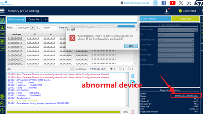

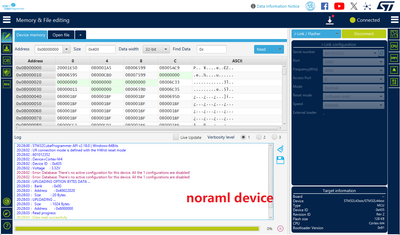

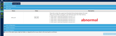

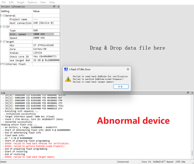

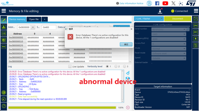

Additionally, STM32CubeProgrammer occasionally crashes when connecting to the faulty device.
2026-01-30 4:54 AM
Regarding the issue where STM32CubeProgrammer cannot read the Flash, I came across a forum post mentioning that the problem is often due to the chip not being correctly selected. However, in my case, the chip has already been properly recognized.
https://community.st.com/t5/stm32cubeprogrammer-mcus/missing-database-files/td-p/81261
SWD communication should be fine.
And the device has already been correctly identified.
