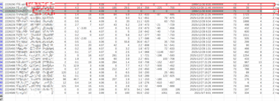

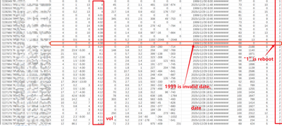

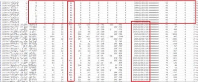

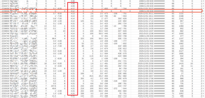

---> Yes, but at that time the battery voltage was still quite high. 4.0~4.2V .
These are the monitoring logs from several devices on the platform.
