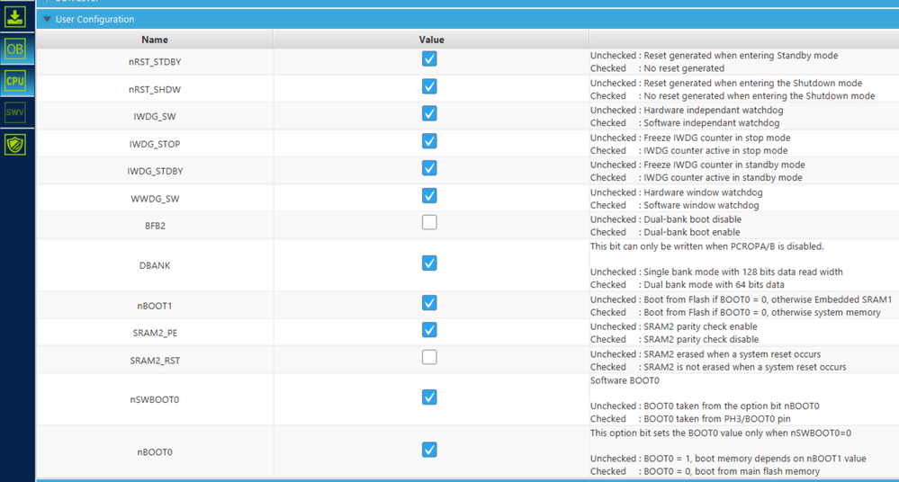

I am using the STM32L4R9I-EVAL board with the BOOT0 selection set to 0. Below is a screenshot of the option bytes when in DFU mode:
