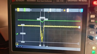

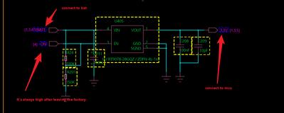

2026-02-02 12:07 AM
We re-examined the current issue and found that the power supply problem is indeed more significant. However, the original oscilloscope truly couldn't detect any anomalies. Therefore, we borrowed a higher-end oscilloscope, and the test results were excellent! Although we didn't capture the voltage level during the reset event, we did successfully capture waveform dips at certain moments!
The voltage dropped to around 2.8V. Although it didn’t reach the BOR threshold, this is very likely the root cause of the issue!
Therefore, we've decided to redesign the power supply and fabricate a new PCB. We hope the next revision will resolve the issue.

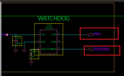

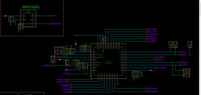

This is the latest version.
this is power .

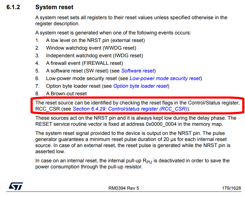

Read the flags in RCC_CSR to determine the cause of the reset.
If only PINRSTF is set, the NRST pin is being pulled low externally, probably by the external supervisor.
2026-01-28 7:56 AM
@daniaoday wrote:So, why did the reset occur?
The RCC_CSR will tell you that:
