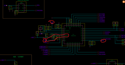

Visual control is not quick. BOR level is set in options bytes and scope require trigger on it... BOR is very sensitive quick detector without spike filter , then nano seconds can reset...
Plus your schematics show VDDA connected, but where ?
2026-01-28 4:36 PM
I used an oscilloscope to measure a 3.3V signal, and it showed no fluctuations. (Due to the bandwidth limitation of the oscilloscope, nanosecond-level fluctuations might not be captured.) Additionally, I've placed a 100nF capacitor on each power pin—could this issue still occur?
