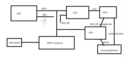

2026-01-29 8:26 AM - edited 2026-01-29 8:34 AM
The device requires battery power.
This is the system block diagram. The LDO_EN signal can be considered as already enabled.
An MPPT control IC refers to an integrated circuit similar to the BQ25570RGRR.
I’ll perform unified tests to read the BOR status, RCC_CSR register, and Flash contents tomorrow. Right now, the device is with other colleagues for analysis.
