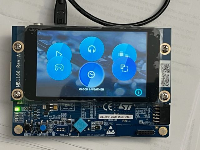

I just had the same issue, even the reset button was doing nothing.
I connected the board, detected by the Programmer, then I pushed one of the touchGFX samples. and all went fine.
It seems the board came blank!
