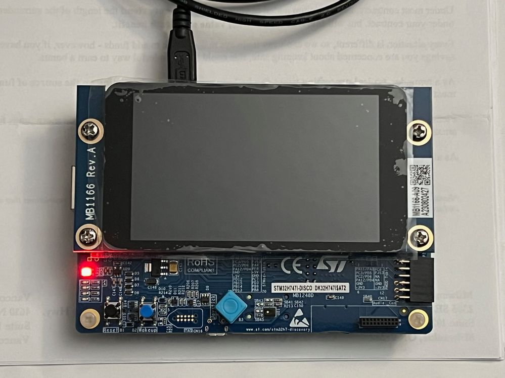

i just received my brand new stm32h747 discovery board, on power-up it does nothing just two LEDs light up, according to the user manual it should be preloaded with a demo.
I checked in cube prog and it reports as blank.
Is it possible that my device got damaged somehow or it is just not flashed?
aren't units tested before shipping out?
Is this a common thing? I don't remember ever receiving a discovery board blank

I am having similar issues. I purchased the STM32H747i-DISCO BOARD FROM Mouser about 4 weeks ago and the board appeared to be DOA except for the 2 leds that should always be on. I contacted Mouser and they quickly sent me a replacement board. unfortunately, this board was also dead except for the bottom power led and the communication led same as the other one. Thats when a search led me here. I tried the Tutti Frutti demo, and it does indeed work. The official demo from ST does not work at all. It will flash to the board, but nothing will happen. I followed the exact same instructions as for the Tutti Frutti.
I am also having trouble getting any of the display examples to work from the CubeIde project examples list.
Is there any progress on this from ST?

I just bought one STM32H747I-DISCO from Mouser, I received a brand new board. I was waiting for it for many months as it was not available anywhere here... I am a newbie to the STM32 Ecosystem, though I am rather experienced with other microcontrollers and Eval boards, so I am starting from scratch ... When I plugged my board, the demo was not running, screen was totally black, only two LEDs ON , same situation than JSext.1. I tried to flash the varous demos and got many errors and couldn't download nor lauch any of them using the STM32Cube Programmer. OK... Then I started with the Tutty Frutty Demo, following the UM 3008 manual step by step. I found that I forgot (not aware of it) to select first the board target in the External Loader menu , just pay attention that there are two entries for H747 in the list, I started with the wrong one :( (btw, this message is for newbies like me) but after a couple of trials disconnecting/connecting STLink and the board I could manage to dowload Tutty Frutty and it was running perfectly well w/o any issues.
Don't forget after the download to disconnect STLink and to reset the board with the reset button.
I dowloaded the other demos: TouchGFX, STemWin and EmbeddedWizard. They are all running fine when loaded individually. At some point, I ticked the box "full chip erase" in the programmer to be on the safe side when loading a new demo. I could download the full demo "STM32Cube_Demo-STM32H747I-DISCO-V1.0.0_FULL.hex" but it is not running as reported by all of you. The screen stays black. My guess at this point is that when I received the board, the Demo FW was most probably flashed but it was not running. Now, I am a bit relieved as it seems my EVAL board is OK from HW point of view. My next step now is to find a good working example/demo that I can compile w/o errors to flash it and run it in the board. It will help me to start in an easy way with this new system as expected... Hope it helps...

I also just received a stm32h747 discovery board from Mouser, on power-up it does nothing just two LEDs light up, One red on top and one green on back
NO DEMO as explain in the user manual
Also, the board was not out of box in a plastic, as I saw on some internet presentation. It was in packaged in 2 plastic bags. It seems , this board not beeing brand new.
The Number is MBH1248-H747I-D03 A230800721.
