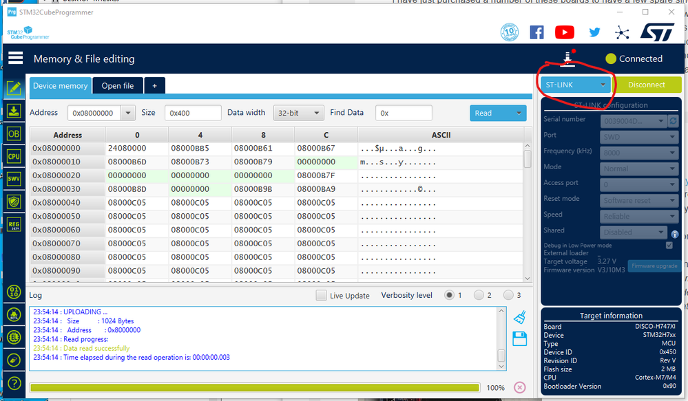

Update: clicking the button on STM32 Cube Programmer that says "USB" and selecting "STLINK" on the pull-down menu enabled connection, resulting to the screen below, so I presume that if I can find the demo firmware it could be downloaded, right?

Theoretically correct, but not quite sufficient, because an external flash must also be programmed, which must first be communicated to the STM32Cube programmer.
To make your work easier, however, you will find in the demo ZIP not only the HEX that contains the programme for the STM32H747 as well as for the external data flash, but also the appropriate BAT file for fully automated programming.
Since the BAT file is not encrypted, the command sequence can also be used for other operating systems if it is adapted accordingly.
Hope that helps?

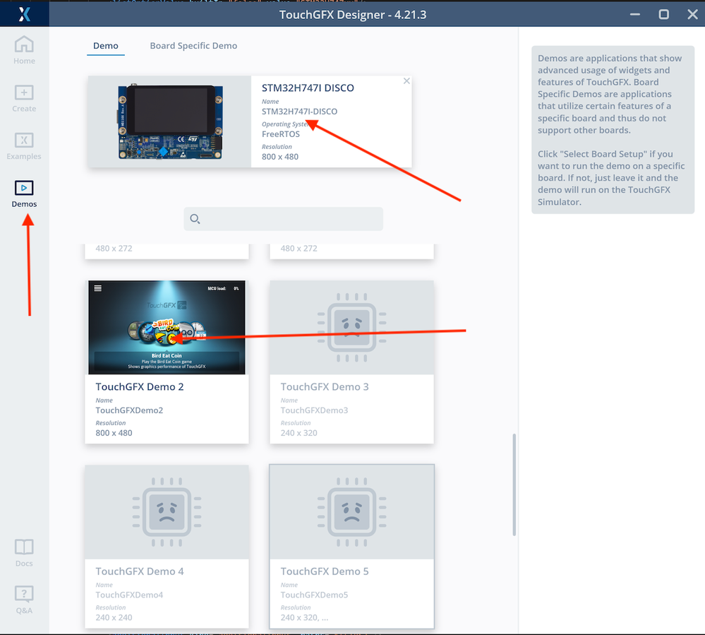

As you are having trouble flashing this you could install TouchGFX, the demo is contained in there, create a project in TouchGFX using the board and the demo and then you can flash it from within TouchGFX, it will handle everything for you.
Yes, the TouchGFX demos worked to my surprise. Once flashed, I found my old code written in CubeIDE could then be flashed as normal. If I flashed directly on a new board without first loading something (even a blank screen from TouchGFX), my CubeIDE code crashed the board​. Not sure if that helps anyone, but just my experience yesterday.
