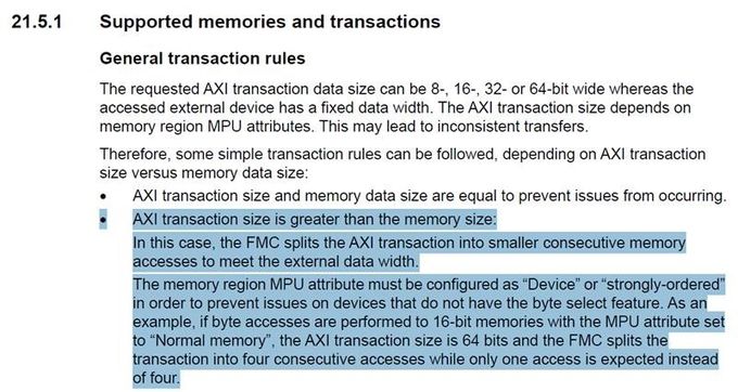

2026-02-17 6:12 AM - edited 2026-02-17 6:26 AM
From an older reference manual revision:
I think you are in the same case as described above. So try to configure the SDRAM region as Device or Strongly-Ordered using MPU.
I don't know why the case AXI transaction size greater then memory data size with no byte selection has been removed from the specification.
Hope that helps.
Hope that helps.
2026-02-17 8:22 AM
Thanks,
this seems to fix my problem.
We already had it sel to "strongly ordered" (tex = 0, bufferable = 0, cachable = 0, sharable = 0) but this did not work. Setting it to "device" (bufferable = 1) fixed the issue.
This text is indeed changed in the new reference manual. Maybe this is due to a possible configuration change in future silicon versions of the h747. It works for now but I think we will still fix this to be sure.
