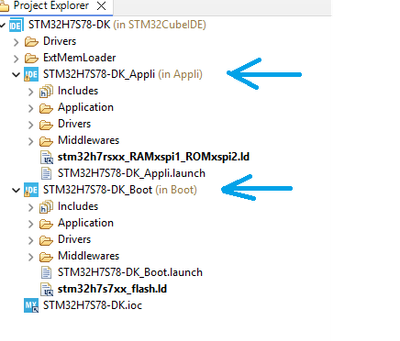

There are two projects to compile and upload to the board for STM32H7Sx devices:
Upload the Boot, then upload the Appli to your board.

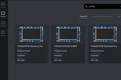

As you are using a discovery board, I recommend to start with TouchGFX designer by selecting the board:
1- Select the board:

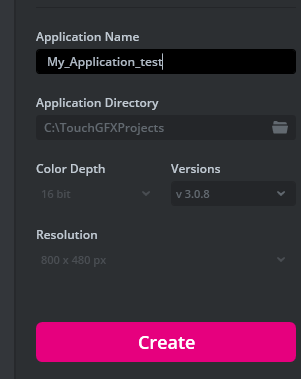

2- Give a name to your project and click Generate:

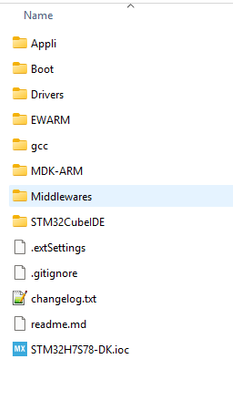

3- The project will be generated with this :

2025-12-24 8:27 AM
