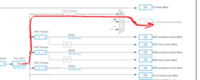

I reconfigured in CubeMX to use System clock mux to use HSE source mux, multipliers and dividers set correctly for 250MHZ operation. There are no errors shown in the setup and I am showing 250 Mhz as the SYSCLK. My AHB is /1, HCLK shows 250MHZ which is feeding the peripheral busses.
While the clock configuration APB1 shows 250Mhz it does not seem to be correct as when I set the timers and prescalers for such the timing is not correct... the bus seems to be running at 125mhz.
For my TMR1 to get 1us clock I have to set the divider to 124 which implies the internal clock is running at 125Mhz not 250 like the clock diagram shows.
I have attached the Clock Configuration from CubeMX that shows no clock issues.

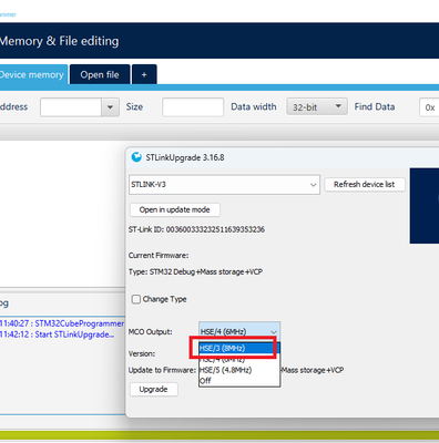

Third, as you are using HSE in Bypass mode with the Nucleo-H563 board that embeds STLINKV3, the clock is generated from the STLINK. Did you update the STLINK to change the Clock output value? you need to have 8MHz like shown from the CubeProgrammer Firmware update menu:

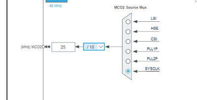

Use MCO2 instead / DIV10:

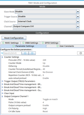

I just checked with my H563nucleo , using tim1 :
starting it
HAL_TIM_Base_Start(&htim1);
HAL_TIM_OC_Start(&htim1, TIM_CHANNEL_1);
-> so 250M / 250 , toggle after 50 (should be = 50us);
scope shows on PE9 : 50us hi, 50 lo, doing what it should do. Thats it.
