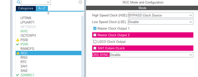

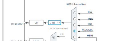

Come on...see here, core at 200M , mco /10 , so 20M to check outside:
And set pin speed high...otherwise maybe see nothing.
...and mco has to be enabled:
