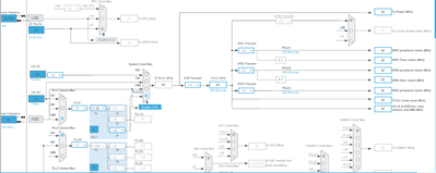

  1. CLOCK CONFIGURATION
We configured PLL through direct register-level programming.
Configuration:
  • HSE used as PLL source
  • HSE = 25 MHz
  • PLLM = 5
  • PLLN = 36
  • PLLR = 2
  • SYSCLK = 90 MHz
PLL configuration registers used:
  • RCC->PLL1CFGR
  • RCC->PLL1DIVR
  • RCC->CFGR1

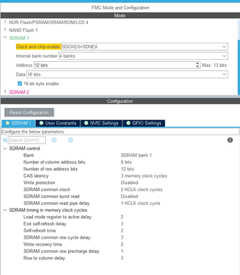

  1. SDRAM CONFIGURATION
SDRAM configuration:
  • SDRAM Bank 1
  • 16-bit data width
  • 4 internal banks
  • 8-bit column address
  • 12-bit row address
  • CAS latency = 3
  • SDRAM clock period = 2 HCLK cycles
  • Read pipe delay = 1
Timing configuration used:
  • TMRD = 2
  • TXSR = 3
  • TRAS = 2
  • TRC = 3
  • TWR = 2
  • TRP = 1
  • TRCD = 3
These values are based on CubeMX-generated settings.

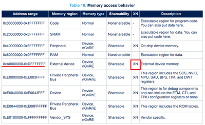

I've already provided some hints previously and as said I can't really help you in the SDRAM configuration. You need to follow the article I have shared previously.
Meanwhile, you need to disable the eXecute Never (XN) from that region using MPU.
You can inspire from the implementation provided in the X-CUBE-PERF-H7 cube package especially the configuration 10 - D1_SDRAM_Swapped - D1_DTCM : execution from SDRAM and data on DTCM RAM.
The target is STM32H7 but the principle is the same.
Attached the files (the linker file which I change the extension to .txt and the system_stm32h7xx.c) where to look at. The associated application note to that CubePackage is the AN4891 "STM32H72x, STM32H73x, and single-core STM32H74x/75x system architecture and performance".
What I suggest is to start by validating the read/write to the full range of your SDRAM. If all is OK translate that as direct access to the registers in the SystemInit() and don't forget to configure the MPU to disable the XN. Don't use HAL in the SystemInit(). You need just to program in bareMetal there...
Good luck.

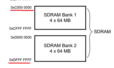

For scatter loading, your process seems to be correct. SDRAM and its respective GPIOs need to be initialized before main(), i.e. in SystemInit(). Unfortunately there is no example available on STM32H5 for this scenario but STM32H743, has such implementation in the HAL, especially in system_stm32h7xx.c
You need to look at blocks where DATA_IN_ExtSDRAM is defined.
Meanwhile, the SDRAM region in STM32H5 is in the range of 0xC000 0000 to 0xDFFF FFFF, according the reference manual RM0481
While, by default, the region is in execute never configuration (XN), according to the programming manual PM0264:
So most probably that's why you are facing a hard fault while executing from SDRAM. You should configure that region to make it executable using the MPU before jumping to the main.
Hope that helps.

HI @mƎALLEm ,
I forget to tell the clock configuration i did for this setup, it is as per the below
also i an running the SDRAM on the 45 Mhz and did the confuguration as per below in mxcube ide
please let me know if i am doing it in wrong way or anything more required for the analysis..
Regars,
Shashank K.
As @mƎALLEm already pointed out, this is a high frequency, so the quality of tracks between FMC pins and the RAM is very important. It is hard to achieve on a Nucleo.
So maybe start from a basic memory test before jumping to the app (pardon the pun).
Enable and configure the DRAM, while the stack and everything is in the internal SRAM.
Find a simple memory test suite (or ask your favorite AI to write one): running 0s and 1s, random values, etc.
Run it on the whole DRAM, or part of it, for a hour. Chances are that such test will reveal a hardware issue.
